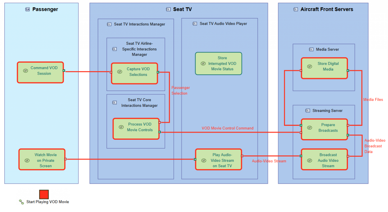

Capella for SysON brings the concepts and modeling approach of Arcadia to SysON, an open-source, web-based modeling environment built for SysML v2.
Designed as an extension to SysON, it extends this SysML v2 native tool with capabilities dedicated to Arcadia.
At its core, the project relies on a SysML v2 library for Arcadia, extending SysML v2 concepts, so that systems can be modeled according to the Arcadia method. By extending SysML v2 with Arcadia concepts and introducing Capella-inspired graphical representations, the project aims to combine the benefits of a standard modeling language with the methodological guidance of Arcadia.
This approach enables engineers to work with SysML v2 models while following the structured engineering activities they already know from Capella.
